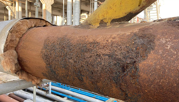

Figure 1: Demonstration of what structural damage to a pipeline may cause

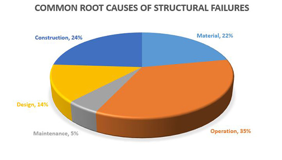

Figure 2: Statistical data: causes of pipeline failures
