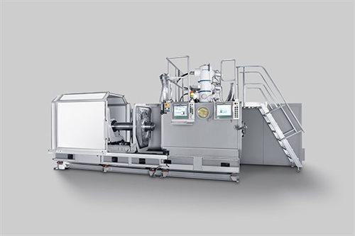

With this system, you can achieve fast drilling and/or removal rates with high precision and low heat input into the material.
The PK 20 perforation system achieves up to 2,000 holes per second in all metallic materials, even in hard-to-process materials such as titanium.
It makes holes or slots in various forms using a diameter of 0.06 – 1.1 mm. The maximum workpiece thickness is 6 mm.
pro-beam PK20 - Perforation System
Technical Data
  • Chamber volume: 2 m3
  • High voltage max: 120 kV
  • Beam power: 3 kW
  • Work space: 1800 mm x 1000 mm x 1200 mm
