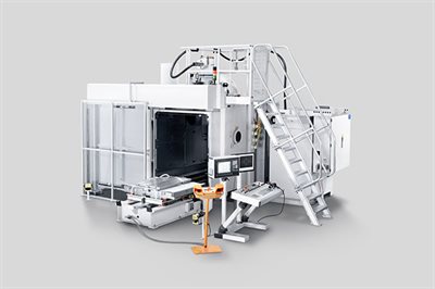

The K 40 electron beam welding system is the ideal choice for research institutions.
The wire feeder equipment allows welding with additional material and the development of 3D printing applications. The system is optionally available with turning/swiveling/lifting equipment.
The K 40 welding system can be operated with any external pro-beam electron beam generator. The optional equipment with a gate shuttle system allows evacuation as well as loading and unloading while the process is running to further increase productivity and availability.
pro-beam K 40 – Electron Beam Welding Machine
Technical Data
  • Chamber volume: 4.69 m3
  • High voltage max: 150 kV
  • Beam power: 45 kW
  • Work space: 2100 mm x 1370 mm x 1630 mm
