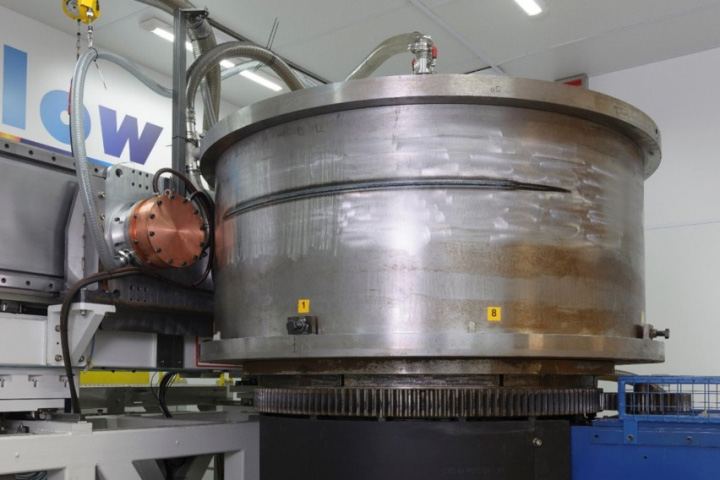

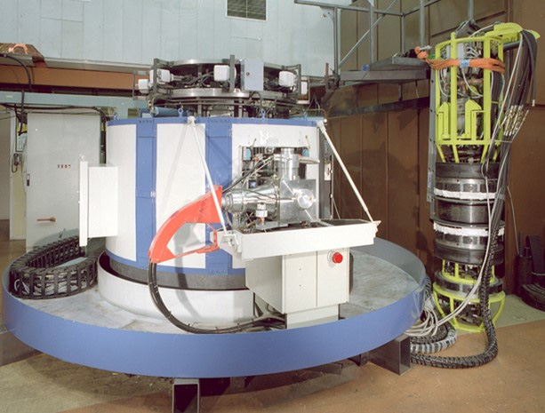

Two types of out of chamber electron beam welding have been developed over the years at TWI and can be applied to thicknesses between 40-200mm. Local vacuum method can be applied through a local vacuum head and it is best for up to 80mm thickness; whilst the local chamber method is more suitable for thicknesses above 80mm.
TWI has recently developed a new local vacuum head for the Nuclear Advanced Manufacturing Research Centre under the INFORM project where a quality assurance station with a BeamAssure probe was integrated into a local vacuum head to reduce the setup time by 90%.
Local Vacuum system developed for Inform project in 2019.

Local Chamber for pipe laying developed in the 1990s

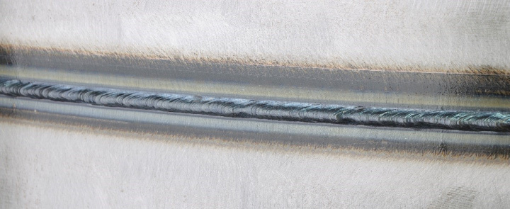

What is the Quality Like?
The quality is the same as with conventional electron beam welding. The photo below shows the top bead of an 80mm thick mild steel canister made under the INFORM project, it is very similar to conventional high vacuum EB welding, but with more vaporised metal deposits due to the lower vacuum.
