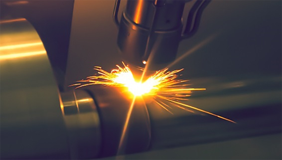

The EHLA nozzle is capable of applying coatings up to in 300 µm thickness, and can also work at traverse speeds of up to 100 m/min. This represents an entirely new capability, and takes LMD from coverage rates of ~10-40 cm2/min to rates possibly up to 250 cm2/min. This is achieved by introducing the powder stream into the line of the laser beam, causing it to melt prior to reaching the melt pool, thus reducing the laser energy input into the substrate component, which in turn reduces dilution.
Image of Extreme high-speed laser application (EHLA). Photo: TWI Ltd
