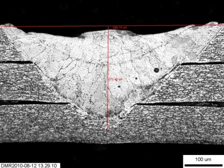

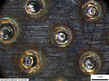

  • Laser welding processing parameters have been investigated at 1064nm and 532 nm wavelengths, for the joining of: aluminium to aluminium, copper to copper and aluminium to copper. Processing parameters investigated include wavelength, spot size, beam quality, pulse length, average and peak power, and repetition rate )Figures 5 & 6)
QCOALA fig 5 QCOALA fig 6
Figure 5 Spot welding of 3 copper foils,
Thickness 0.1mm at 532nm (Photo: TWI)
Figure 6 Reproducible spot welds with a 532nm laser.
(Photo: TWI)
